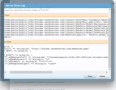

I see these errors :
I also changed a email to gmail inside |Options|Email|Default Email Address
instead of a @domain name, problem persists. Users can not retrieve passwords nor register, as there is no confirmation link/reset link or anything, email does not arrive.
"...failed: Unable to send mail. - library/Zend/Mail/Transport/Sendmail.php:137"
I see couple of these errors, but when I try to retrieve a password, I do not see anything in error logs.

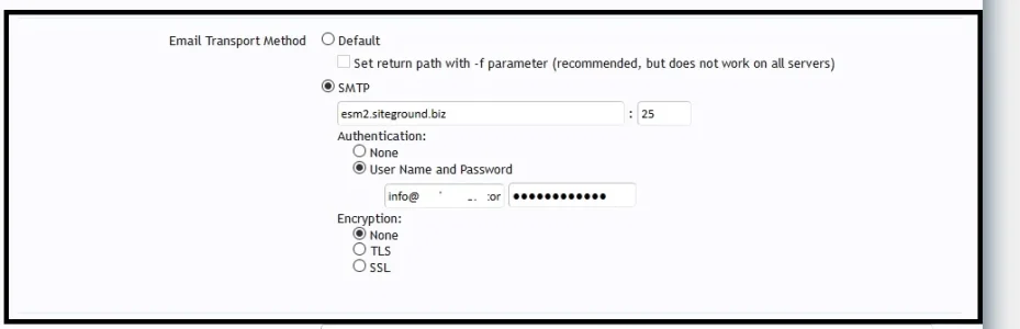

So here is what we did.
1. We configured email to SMPT like this - Not sure if this is best way? Perhaps @Mike or @Brogan know if smpt is a way to go?
2. Our email was flagged as spam by http://spamrl.com/, that is why emails got bounced back. I requested them to white list it, and apparently it will work for 7 days, after that, not sure what happens.
If anyone had a similar issue, please let me know how you solved it.
