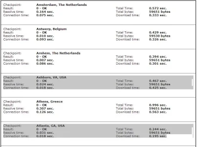

Can't really complain about mine (China showed 0.00 - but that's because all traffic from them is dropped). Server is based in Florida with ServerComplete.
