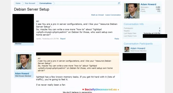

I was thinking of making a Debian nginx guide. Big point on making those guides though; is to explain it (word it) in such away that even a Windows noob, who doesn't even know there is a such thing as Linux, could still follow and understand it (or at least blindly follow it without understanding).
