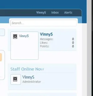

Just completed a new install and all the images are not showing up all the url's seem to be in place any thoughts??

Then it sounds like either you haven't uploaded the images or it's server related, in which case you should contact your host.
You may also need to chown them, although I shouldn't think so.

Found the problem!! OK not sure what you use for an FTP software I use File Zilla now in File Zilla you have three file transfer types you have Auto, ASCII and Binary my software for uploading files was set to ASCII for some reason it corrupted every image file that I uploaded so I changed the setting to Binary and now I have all the image file working!!!! This may be one to keep on the books if anyone has this problem........
