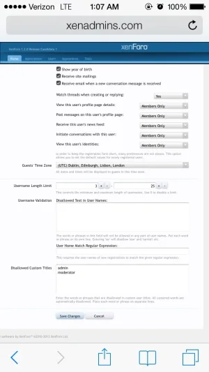

Not having migrated yet, I have to ask... Is there an ACP option to limit usernames to alphanumeric characters?
No. That will reject a decent amount of usernames. You'll want to use:
^[a-zA-Z0-9 ]+$

I've been using this.
^[a-z0-9]++(?:\s[a-z0-9]++)?$

This is what I use:
^[A-Za-z0-9][\w\-\.\s]+[A-Za-z0-9]$
Must START/END with an alpha-numeric.
Can contain alpha-numeric, _ - . and space.
