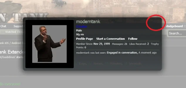

I'm also noticing that the "X" (exit) is missing from membercard popup. The hotspot is there, as you can see the mouse pointer change to a hand when you place the pointer where the X should be. Maybe a style issue that happens to be related to the issue you are having.
This may be an add-on conflict, a color issue or a style problem. It sure will confuse your members if left unresolved.
