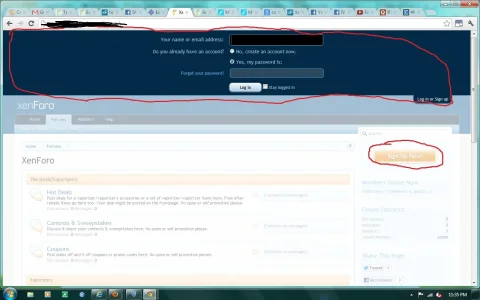

Hi, I have search the forum in search of a clear way to change the color of the the drop down "log-in" box and "sign up" button. I have tried making edits to the log-in css, and adding code to the extra.css with no success. Can somebody please help me or guide me to the correct answer, I would appreciated very much. Im a newbie, so if anybody know of any video tutorials, that would be great. Also one of the best tutorial i have seen that cover xenforo is http://xenforo.com/community/threads/how-to-change-almost-anything-quickly-and-easily.33239/

For the login bar:
Style Properties -> Login Bar
Container is of course... the container :), and you can just play with the rest to figure it out. Sometimes what I'll do is make a setting like bright pink so I know what it controls.
As for the login button, it's under Style Properties -> Buttons -> Sign Up Now
Thanks Russ, I was able to change the "sign up now" button, but the drop down "login " box did not work. I went to the style properties->Login bar, then I select my color, but like i said earlier it did not work. Is there anything else i can do to change the color of the drop down login box?
What other templates are you using? Sometimes style developers utilize extra.css(or a custom css file they created) and it could be overwriting the style properties.
