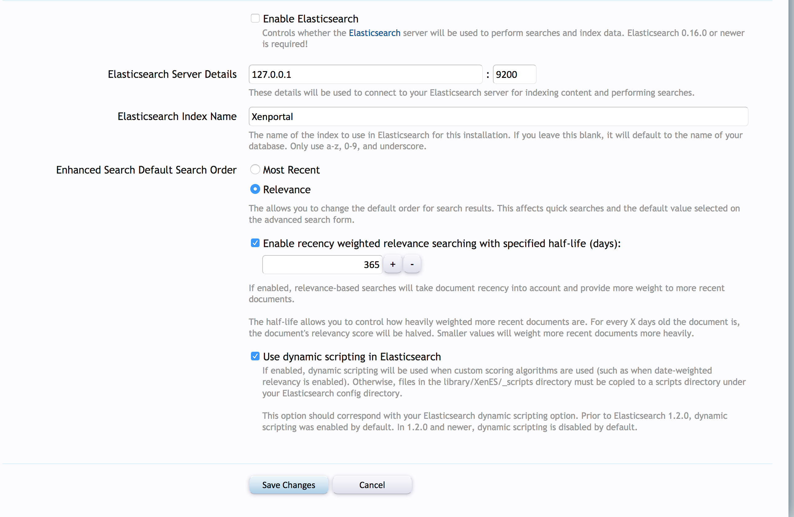

hy some can tell me if my server is configured properly and working fine
here is screen print
Sorry to say i am newbie
Hey @Mike can you check my config as well?
Search Settings:
The Index name is same as Cluster Right? in cluster.name: (elasticsearch.yml)
Also what does this do "Enable recency weighted relevance searching with specified half-life (days)" i don't understand
this description here:
The half-life allows you to control how heavily weighted more recent documents are. For every X days old the document is, the document's relevancy score will be halved. Smaller values will weight more recent documents more heavily.
is to vague for me.
as for elasticsearch
are these values correct?

i have 64 Gig Ram but i only allowed 8Gig for heap
also from the library/XenES/_scripts folder i copied
xf-date-weighted.groovy
xf-date-weighted.mvel
to /etc/elasticsearch/scripts
also /var/elasticsearch folder
i ran chmod 755 on it & chown -R elasticsearch:elasticsearch
+ chkconfig --add elasticsearch
chkconfig elasticsearch on
then service elasticsearch start
i am on Cent OS 6.8 running WHM/Cpanel Apache 2.4, PHP 7
and i allowed ports 9200 & 9300 in IPV4 TCP In on Config Server FireWall (CSF)
This All Correct?
Unless you have a specific reason to do otherwise, you should leave the index name blank. As is, your index name has disallowed characters (see the description; it's lowercase only). Beyond that, the configuration is mostly down to your preferences.
You haven't explained whether you're getting any errors or what problems you're having (once you fix the index name).
