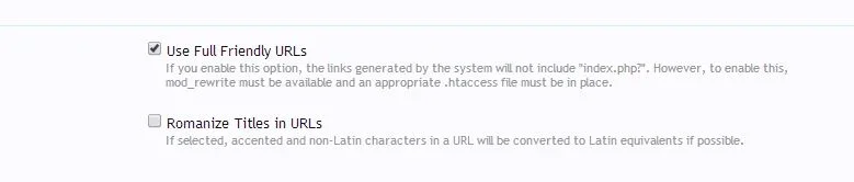

Ya still not working. Same thing homepage works, but nothing else. If you had "community" anywhere your probably going to have to remove it. I don't know if you run any add-ons etc. either. Mine is just stock with the setting above and it works. Did you change anything else recently?
going to have to wait to get home and mess with this. Might have to revert it back to community :(
Ya I just would double check everything. There is no reason that you can't have it on the root. Make sure to go through your setting and that there is no custom route for community. I really think there is something still directing to it. If not you could probably put a ticket in, I am sure it's something real simple. Best of luck sir I am sure that you will get it figured out.
Alright can you check it one more time..
I put the old file back..

Looks good sir, everything seems to be working now. Did you change something? It's going to "forums" now like it should be and not "community".
