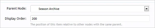

My advice is to use orders in increments of at least 10 (10, 20, 30, etc.), then you have flexibility for the future with regards to inserting additional nodes.
The screenshot is just from editing a node. It hasn't changed. Display order is relevant only between sibling nodes.
