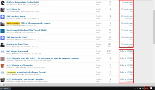

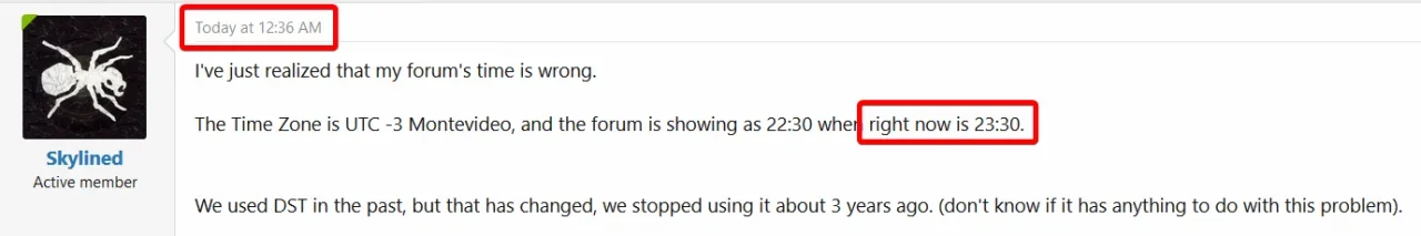

I've just realized that my forum's time is wrong.
The Time Zone is UTC -3 Montevideo, and the forum is showing as 22:30 when right now is 23:30.
We used DST in the past, but that has changed, we stopped using it about 3 years ago. (don't know if it has anything to do with this problem).
Out of curiosity, do you have the same issue here?
This is very likely down to your underlying timezone data on your server (given that the TZ details were changed fairly recently). This is generally something that can be updated on your server (though you'd need root access).
Overall, this is almost definitely a server issue. Specifically, the time zone data needs to be updated. I have updated ours here (though it's possible PHP will need to be restarted), but that is something that has to be done on each server.
We use the correct timezone for this location, so unfortunately there isn't much else we can do.
