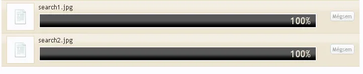

Hi,
when I upload a text file, it works fine. But when I upload am image, the progressbar reaches 100%, and then it just stays there:
This is probably when it would create the thumbnails (?), and it looks like it cannot cope with it. There is nothing in xF's error log.
Do I need anything special on my server to be able to accept images?

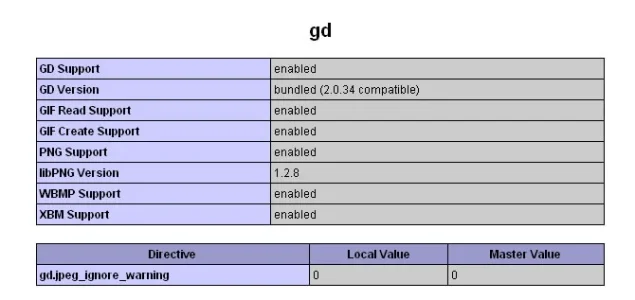

Yes, I do have GD, but jpeg support is not included:
I will play around with it a little to see what I need to get it in there. It's missing from my real server as well, not just this virtual machine that I'm testing on.

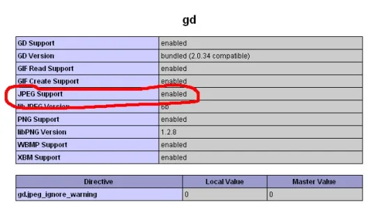

libjpeg-devel needed to be installed, then php recompiled. now works fine.
