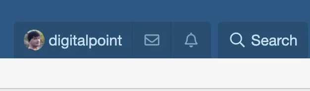

Are you sure that's not your avatar itself? Your avatar has a round maple leaf that doesn't extend to the edges of the image. So when the radius of the image is changes to make it round, you would have a white border around it (since the red part doesn't extend to the edge.
My avatar here:
The raw version of your avatar doesn't extend the red part to the edges of the images (as I mentioned):

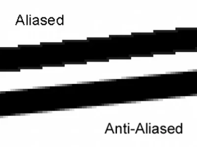

For the second one (the glossy rounded one), I'd guess that's ultimately a browser issue that has to do with anti-aliasing and how browsers handle pixel sizes that aren't integers. Like if you are wanting to "cut out" a circle exactly at the edge of the circle in the original image, and the source image is antialiased to have a white background (where anti-aliasing is blending the edges to the background) like so:
You end up with pixels that are white(ish) along the edges because the background of the image is white.
Normally you could use a transparent background so the circle could be antialiased and blended with transparency instead of white. Unfortunately, I believe XenForo converts avatars to JPEG images which don't support transparency.
Your best bet would be to have an avatar that is fully square and then let XenForo handle making it circular with the border-radius. Fundamentally the issue is you are trying to make it circular yourself and then XenForo makes it circular again, but along the way you are dealing with the anti-aliasing from you trying to do it yourself.
