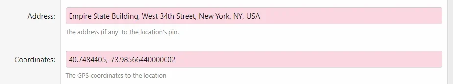

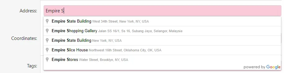

Without adding an id to the textbox code, an entirely new custom field might need to be created to make a Google Places API autocomplete custom field.
203800
And from that, you can also grab the GPS coordinates for another custom field that can be regex'ed (if necessary for).
203802
