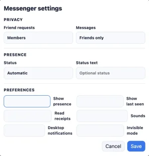

Awesome support.... another issue i'm seeing.
Messenger settings pop-up, under Preferences at the bottom, nothing is clickable or fillable. (see screenshot)
Thank you for bringing this to my attention and rest assured this will soon be resolved. I thank you for your continued patience!

Thanks for spotting this. The settings issue is fixed now, and while going through it I also found a couple of other problems with Last Seen and friend request privacy, so I fixed those at the same time. It should now look like this :-) 1.0.9 is now available to download.

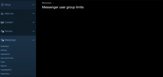

Found another, i think...
Pretty sure the error has to do with a blank user group limit page in admin.
Server error log
  • TypeError: Template admin:eggy_mf_admin_groups error: Cannot access offset of type string on string
  • internal_data/code_cache/templates/l1/s0/admin/eggy_mf_admin_groups.php:24
  • Generated by: jeff
  • Sep 2, 2026 at 3:43 AM
Thanks again for reporting this. I tracked the error down to the Messenger user group limits template.
The template was using:
<xf:set var="$group" value="$row.group" />
<xf:set var="$p" value="$row.perm" />
That caused XenForo to treat those values as strings rather than evaluating the actual template variables, so when the template later tried to read something like:
{$p.friend_limit}
it triggered the Cannot access offset of type string on string error. I’ve corrected it in 1.1.0 to use XenForo’s proper expression syntax:
<xf:set var="$group" value="{{ $row.group }}" />
<xf:set var="$p" value="{{ $row.perm }}" />
I apologise for the amount of beta testing you’ve ended up going through tonight, and I really appreciate you sticking with it. Messenger 1.1.0 has now been released to resolve this issue.
