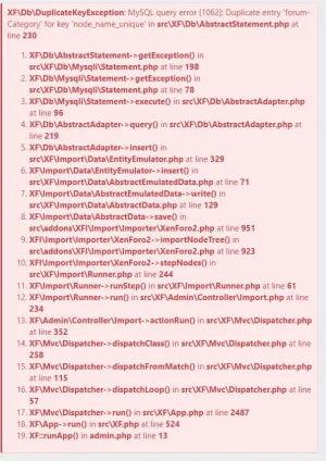

Are you trying to merge via the standalone importer? It looks like the install is being interrupted and it's trying to write the same node ID twice. Are the nodes named the same? You might need to rename one.
Also doubly make sure you're using the most up to date importer.

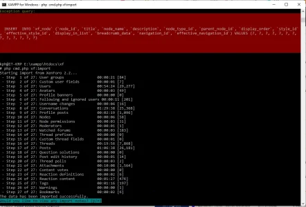

Currently I've created another test DB and uploading the board I want to merge so I can compare the XF_node table where the unique node id is at. hoping I can find the duplicates there
Sounds like you could do with a script to find dupliate references that allows you to change them.
Perhaps @MattW can help you with this database merging.
So I fixered it :) Running the finalize commands now. in the screenshot from phpmyadmin you can see under "node name" the 1st two values are forum and hardware, everything else is Null. I set those to null and three others that were not null and restarted the merge. Thanks for the tips and hints given :)forum-merge.webp
