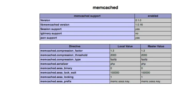

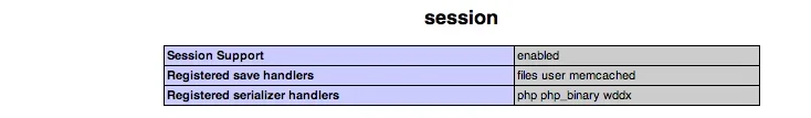

I have a same problem.
Trying to install memcached in Wheezy. I have installed php5-memcache, php5-memcached and memcached.
And when I test it with this:
<?php
$mc = new Memcached();
$mc->addServer("127.0.0.1", 11211);
$result = $mc->get("test_key");
if($result) {
echo $result;
} else {
echo "No data on Cache. Please refresh page pressing F5";
$mc->set("test_key", "test data pulled from Cache!") or die ("Failed to save data at Memcached server");
Nothing appear. Just a white blank screen.
Any suggestion?
