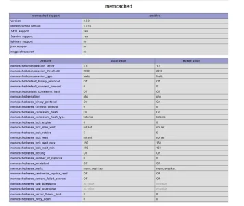

Is Memcached installed?

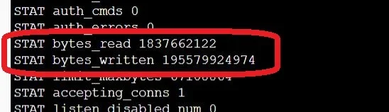

To check if it's caching:
[root@server ~]# telnet localhost 11211
Reply:
Trying ::1...
telnet: connect to address ::1: Connection refused
Trying 127.0.0.1...
Connected to localhost.
Escape character is '^]'.
Command:
stats
Changes when caching:
