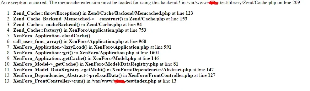

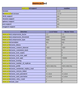

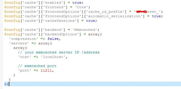

DRaver Active member Dec 8, 2014 #1 I installed Memcached (apt-get install memcached) and php5-memcached ( apt-get install php5-memcached). Memcached ist running. I can connect via telnet. PHPINFO say: My XF config.php I´ve got this error message: So what is the problem?

Mike XenForo developer Staff member Dec 8, 2014 #2 The class names ZF uses here are a little misleading. What you've loaded into PHP is Libmemcached in ZF terms (http://php.net/manual/en/book.memcached.php); Memcached in ZF terms refers to http://php.net/manual/en/book.memcache.php . Upvote 0 Downvote

DRaver Active member Dec 8, 2014 #3 So it´s work if i installed php5-memcache, without (d). memcached demon with memcache php client works but memcached demon with memcached php client did not work with xf. That's strange. Upvote 0 Downvote

Mike XenForo developer Staff member Dec 8, 2014 #4 If you want to use what you have installed, you need to change your cache backend to Libmemcached (and configure it as necessary for that, though it's similar). Upvote 0 Downvote
