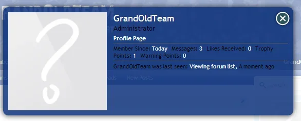

I've spent the past hour or so trying to change the colour of the text on the Membercards (as indicated)
I need @mutedTextColor to remain Black so I can't edit that. I need to edit this text exclusively.
If anyone could advise or kindly direct me to where I can find an answer I would be most appreciative.
Thanks again!

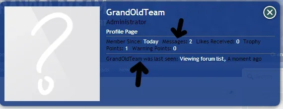

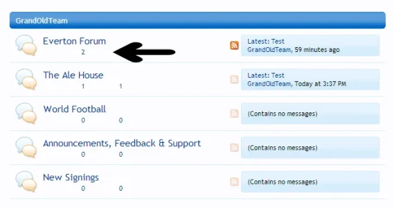

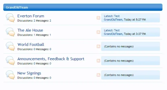

That's certainly done the trick, but it has also altered the text elsewhere;
I'm needing all amends to be exclusive to the membercard bit. The forum is here: http://grandoldteam.com/xf/index.php

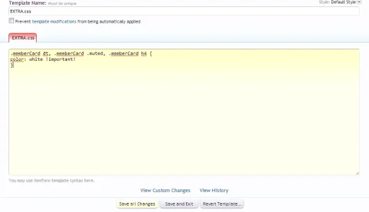

The current EXTRA.CSS looks like;

So should the code in EXTRA.CSS look like;
.pairsInline.lastActivity .DateTime.muted {
    color: #FFFFFF;
.pairsInline dt {
color: #ffffff !important;
.pairsInline.lastActivity dt {
color: #ffffff;
.DateTime.muted {
    color: #ffffff;
If so, the problem remains
Thanks Kat,
The forum 'Discussions' and 'Messages' text revert back to their normal colour, but the membercard goes back to the initial problem.
I'm being a right pain here aren't I?
Thanks Kat,

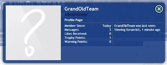

Thank you, this did the trick :)
If anyone stumbles across this thread looking for an answer, what my eventual code was in Extra.CSS was;
.userStats.pairsInline dt, .pairsInline.lastActivity dt, .pairsInline.lastActivity .DateTime.muted {
color: #ffffff;
/* Member card stats and last activity in two columns */
.xenOverlay.memberCard .userInfo .userStats {
float: left;
width: 49% !important;
border-right: 1px solid #556655 !important;
.xenOverlay.memberCard .userInfo .userStats dd {
float: right !important;
.xenOverlay.memberCard .userInfo .userStats dt  {
float: left;
clear: both;
.xenOverlay.memberCard .lastActivity {
float: right;
margin-top: 0px !important;
padding-top: 0px !important;
border-top: 0 !important;
.xenOverlay.memberCard .lastActivity.pairsInline dt {
float: left;
clear: both;
.xenOverlay.memberCard .lastActivity.pairsInline dd {
float: left;
clear: both;
Producing a membercard of;
Big thanks to @EQnoble @katsulynx @Brogan and @Amaury - really appreciate it. Amazing level of rapid support. I was with vBulletin for 8 years... the switch to XenForo already looking a good'un.
