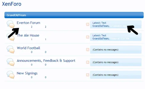

Hello There,
I'm new to XenForo (Purchased it an hour ago...)
I've spent the past hour or so trying to change the colour of the text on the Membercards (as indicated)
I need @mutedTextColor to remain Black so I can't edit that. I need to edit this text exclusively.
If anyone could advise or kindly direct me to where I can find an answer I would be most appreciative.

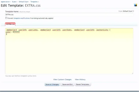

#7
.memberCard .userInfo .userLinks, .memberCard .userInfo .userStats, .memberCard .userInfo .lastActivity {
color: white !important

Use this, @DannyEFC:
color: white !important;

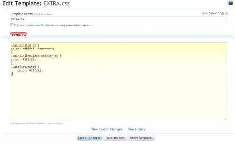

If you are trying to target only where the arrows in your image point you can paste this in extra.css..
.pairsInline dt:nth-child(3) {
color: #ffffff !important;
.pairsInline.lastActivity dt:first-child {
color: #ffffff;
if you want to select on all of dt in the membercard use this instead...
.pairsInline dt {
.pairsInline.lastActivity dt {
color: #ffffff;

Both the below;
.memberCard dt, .memberCard .muted, .memberCard h4 {
color: white !important!
...Didn't do the trick.
This from @EQnoble
.pairsInline dt {
color: #ffffff;
Has produced this - so very nearly there, just 'A moment ago...' left.
Any ideas?

Sorry didn't realize you wanted that part :)
.DateTime.muted {
    color: #ffffff;
