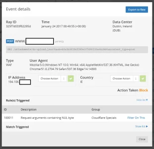

using ms edge, causes this trigger.

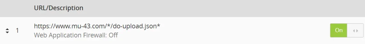

Before you ask... yes I disabled the rule and it loses its self with OWASP rules....
Can you explain what you mean by "loses its self"? If you turn "Cloudflare Specials" in WAF, does the problem go away, or do the OWASP rules also have to be turned off to stop the problem?
I believe I have a workaround for this. It appears to be related to a bug in Edge with regards to how it handles an undefined file type in the file read function. It sends a content type of "undefined" to the server. I overrode this to an empty string which is the spec-defined default, which makes it send application/octet-string (what the other browsers send already). This appears to bypass the WAF rule.
One of the workarounds mentioned above is an easy way to solve it, as is disabling the 100011 rule directly. Alternatively, you can overwrite js/xenforo/attachment_editor_new.js with our version here: https://xenforo.com/community/js/xenforo/min/attachment_editor_new.js Note that you will need to hard refresh to ensure that you aren't pulling from cached JS.

  "id": "3484357ba845380a",
  "country": "US",
  "ip": "75.131.113.23",
  "protocol": "HTTP/2",
  "method": "POST",
  "host": "www.christianforums.com",
  "user_agent": "Mozilla/5.0 (Linux; Android 7.1.1; Pixel Build/NOF27B) AppleWebKit/537.36 (KHTML, like Gecko) Chrome/56.0.2924.87 Mobile Safari/537.36",
  "uri": "/attachments/do-upload.json?hash=5cc7fa470b07cc17e5a48d6dff18c010&content_type=post",
  "request_duration": 0,
  "triggered_rule_ids": [
    "100011"
  "action": "block",
  "cloudflare_location": "ATL",
  "occurred_at": "2017-03-31T15:05:48.1Z",
  "rule_detail": [
      "id": "",
      "description": "ARGS:UPLOAD"
  "rule_message": "Request arguments containing NUL byte",
  "type": "waf",
  "rule_id": "100011",
  "zone_id": "a4cf2ba1548dd21e9766a88865a21265",
  "cookie": ""
