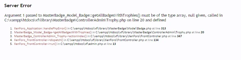

Installed on localhost, get the following error:-
Also have Waindigos trophies installed - saw an earlier post saying that issue was fixed, but disabling trophies stops the error so . . not fixed here :)
Yeah i'm waiting to this add on to be expanded so it can replace that addon and also medals, then it's 3in1, otherwise they will conflict, even if without one error, this addon removes the waindigo trophies functionality.
I hope this addon creator wants and is able to make this one amazing expansion of the trophy system. :)
Both add-ons extend to same controller action, so either one of them needs to be disabled. I have added a change to prevent that error, thanks for your report.
PS: Just take a look at Waindigo add-on, he replaced the controller action with his own, that why it broke my add-on.
