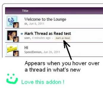

But you do need to hover over the thread for the 'Mark as Thread' link to appear. Just like you need to hover for the page navigation to appear in a thread list.

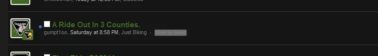

Member_68162
Besides that I guess that you can check if the automatic template edits worked.
That was the problem, the edits weren't made. I made the template edit and "Mark As Read" appears twice now (see image below), how can I fix that? And thank you for the fast reply.
