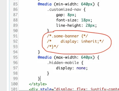

UPDATE: I have reverted my PAGE_CONTAINER template and in that case upgrade process passed through smoothly. I had pretty extensive changes there so it looks like something has interfered with upgrade process and eventually made it broken. (I would expect some "template merge" conflicts, etc)
