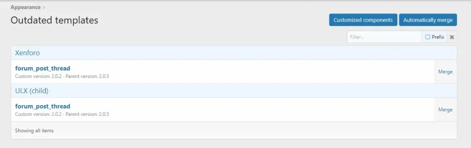

As a new Xenforo user, this is my second upgrade. At first one (from 2.0.2 to 2.0.4) I did not face any problem.
But during my last upgrade (from 2.0.4 to 2.0.5) I get the following error message at "forum_post_thread" template for both default and custom style.
Oops! We ran into some problems.
The custom template is out of date but has been edited more recently than the parent. Merging can only be done by hand.
I have added some extra custom codes at this template while I was using 2.0.2 version. I wonder why I can not merge it ?

For fixing that problem at "forum_post_thread" template, I had to change something in the template (and then change it back) to make it disappear from the list of outdated templates. Is it correct action ? What is your suggestion for hand merging?

You will need to make a note of the changes you have made to the templates, revert them, than add the changes back.
Thanks for your reply. I will do as you explain. But could you please tell me why or how does it happen ? As I said there were two more templates that I have added some codes, but these template were merged manually.
