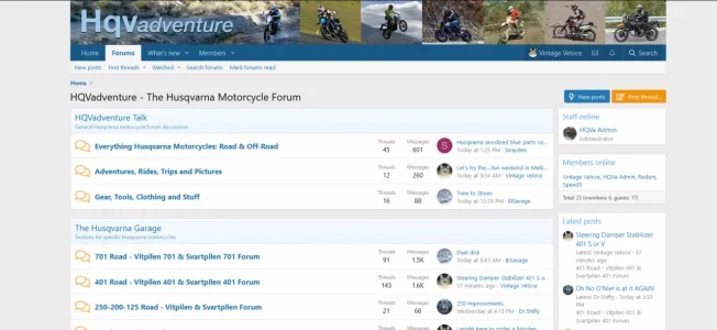

I want to make the Sub Navigation Row background color the same width as the Maximum Page Width: 1400px.
By default the Sub Nav Row seems to extend the full width of the window, wider than the Max Page Width.
I put this in the extra box for the Sub Nav Row:
max-width:1400px;
and it did make it the proper width, but it was aligned to the far left of the window.
so I added this:
margin: auto;
But that makes the box and text centered in the page and small, no longer 1400px wide.
I still want the text left justified in the Sub Nav Row, I just don't want the Sub Nav Row background color to extend any wider than the Max Page Width at 1400px.
As seen here:

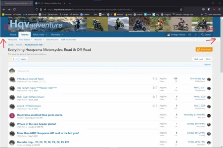

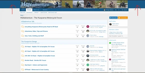

I just set up a light colored style, and that has revealed to me that it isn't just the Sub Navigation row that extends too far to the sides. The area above that, maybe the header background color?, also extends past the Max Page Width.
See the red arrows in the picture below.
Any help please?

Ok, so I did some googling and I added p-header to the call, like this:
/* edit: Make header color backgrounds only 1380px */ .p-header, .p-nav, .p-sectionLinks { width: 100%; max-width: 1380px; margin: auto; }
And that seemed to work! But, I was just plugging around: was that a good method to fix this or will there be side effects that I just don't understand?
If it displays as expected at all screen widths, then it's good.
Resize the browser or access via different devices to confirm.
