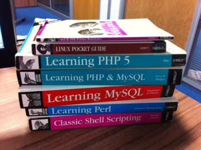

Oh, and the book collection I have at work I mentioned previously
