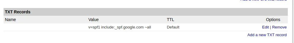

Okay, did I do this correctly? The attachment is a screenshot of my DNS settings.

The name should be the domain you're sending them from - 556files.net in this case.
You may have to leave the name field blank, or enter an @ symbol to make it apply to the root domain - it depends on your DNS provider.

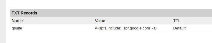

Cool, thank you. My host wouldn't let me use @ but it would let me leave it blank. If I type in 556files.net, then it just shows up as if I had left it blank. Or in other words, intentionally leaving it blank and typing in 556files.net both result in the field being blank.

Negative. It says invalid if I do that and won't take it.
So blank indicates the root? Will that work since my email is coming from Google's server?
Yeah, spf basically tells email providers what servers are allowed to send emails for a specific domain, so you set the domain (name) to the domain you're creating the record for.
It could just be taking a bit of time to refresh through the dns caches - eventually, you should see it detecting the record here: https://mxtoolbox.com/spf.aspx if you enter your domain.

It said to allow 48 hours for propagation. Maybe it just needs a few minutes.
Your SPF record is correct. I use Linode as well.
Linode refresh DNS every 15 minutes, and then depending on your TTL, it can take up to 48 hours to propagate (although usually a lot less).
Give it some time before you test it.
That being said - mxtoolbox is already reporting it as operational - https://mxtoolbox.com/SuperTool.aspx?action=spf:556files.net&run=toolpage# (they query the authoritative DNS directly).
It can still take time for other DNS servers (eg gmail's) to pick up the new record.
