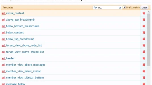

XenForo is pre-loaded with a load of special templates (all prefixed with ad_ ) which are blank, and will enable you to edit and paste your ad-provider's code in.

Chris I didn't know that I found it so would I just add the code in the template ? I'm just not sure how to go about this
Chris D
XenForo developer
Staff member
#5
Yeah exactly right, but there's lots of these ad_ templates.
You can use any that you like, and each one represents a different position on your forum.

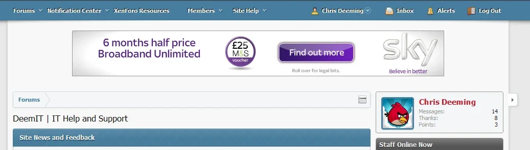

If you were using Google Ads for example, you'd get some code from them and paste it anywhere in your ad_above_top_breadcrumb template. That would appear here for example:
