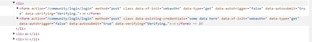

2) Providing existing credentials when logging in
This works by
  1. Cloning the form for button Passkey bia browser developer tools
  2. Adding data-existing-credentials="..." to the cloned form
  3. Calling XF.activate() on the cloned form to activate the handler code
  4. Finally clicking button Passkey of the cloned form
Using the second approach also allows me to perform a paswordless login with a Yubikey 4 which even can't perform user verification.

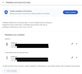

Using any U2F/FIDO2 credentials "just" for 2FA would be fine.
This is what for example Google does - I can use a YubiKey 4 for 2FA but not for passwordless login:

Navigate up again to the opening <form> of the copy-pasted code and insert attribute data-existing-credentials.
It should now look similar to

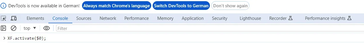

Now click on Console, enter XF.activate($0); and press enter
Click on the second Passkey button (the one you just created) and test if you can login with one of the YubiKeys.

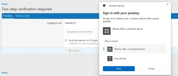

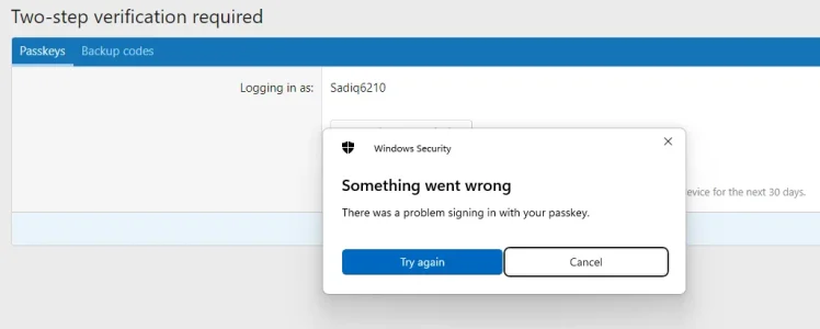

1. I enabled/added passkey from my iPhone, all is good if I try to login using the same iPhone.
2. I tried to login to my account using the laptop (windows-11) and I have been redirected to this page:
3. I clicked Next and scan the QR code using my iPhone, then I got this error:
Currently I am not able to access to my account from the laptop
