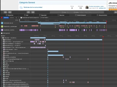

Since a few days ago the loading of my Xenforo installation takes several seconds to complete.
I have seen in the timeline that css.php takes a long time to finish the process and I think this is what slows down the forum.
First I thought it was because of something related to the custom theme I use, I've changed to the default theme and it keeps happening, what can be ? someone else has this problem ?

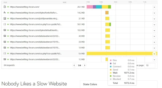

With and without this mod I experience this, it happens randomly. Sometimes it loads fast, sometimes slow.
