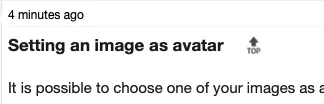

I asked ChatGPT and it gave me several options, none of which worked because the XenForo editor is limited. Obviously. So in the end it found me a little icon for an internal link. Because it's small it doesn't look too bad above an entry, but it's still not very pretty:
ChatGPT suggested I put every topic in its own post. That way I don't need the #3 Headings, can simply link internally and I'll be able to put a little icon right where I want it. It's probably the best advice it gave me. The downside is that some entries are pretty short. Still, I'm considering that now.
