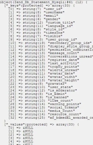

Yep. Again, let's see what's held in $users... bearing in mind I don't have a token_valid column so I'll just get all my test users:
PHP:
$users = $db->query("SELECT * FROM `xf_user`");
I already knew, but that tells me straight away, $users isn't holding what you think it is. It's holding the raw MySqli database statement object.
