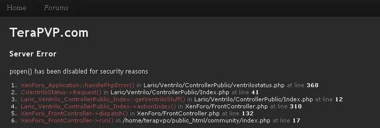

I just installed the add-on today. I immediately received a report that our site was no longer accessible. I was able to confirm when I tried to change to our forum page I received the following error:
I disabled the add-on and the site returned to normal.

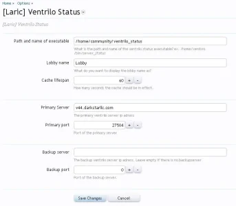

I then re-checked the instructions. I downloaded the Linux Server zip and copied the ventrilo_status file to my web server. I confirmed the path then copied it. I re-activated the Laric add-on, quickly pasted the path in the ACP and set up the IP/port for my vent server. The issue remained.

Laric
your site has disabled the function popen (program open). Without it php can't execute the ventrilo_status program to get the actual status.
Laric
Solution for the "popen disabled" issue
In order to eliminate this error message you need to do ONE of the following things:
  • Remove the popen string from the disable_functions at php.ini* file
  • Ask your hosting provider to remove the string above if you don't have an access to the php.ini* file

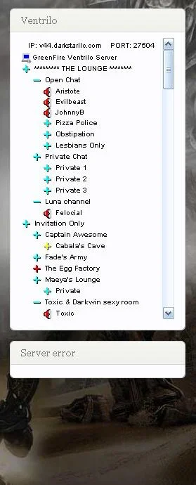

Getting closer but still not there yet. You can see in the first screen shot I do have a working ventrilo monitoring script using the hack where I use another site. You can see the vent server name and IP address, and that it is up and working.
I am getting "server error" when using your add-on. I have my ip and port settings correct. I have the server path correct and have tried starting with /home/ as the example shows, also home/ and www.terapvp.com/ All yield the same result. Any ideas?

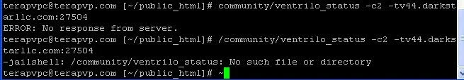

also if you have shell access on the server can you try the following command
/home/community/ventrilo_status -c2 -tv44.darkstarllc.com:27504
And see that you get an about in the lines of

Ryan Kent
I am totally unfamiliar with working in Linux. I have secure access. I was able to use Putty to establish a connection. I tried to execute the code you offered from the main directory but received "no such file or directory". I guessed it was because there wasn't a "home" directory but instead it was the public_html directory, so I changed into it and tried the below.
Any guidance as to what I need to do would be helpful. I tried with and without a leading slash
