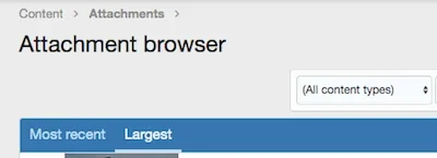

After years using Xenforo...I've never actually been in this area of the ACP. Really really nice this area can take you directly to the thread post/attachment in question!
One more question please. In my ACP...I don't get the "All" option for sorting the attachments...I only get "Most Recent" and "Largest":
I'm running XF version 2.2.5...was this something possibly added in a more recent version of XF...or am I doing something wrong?
Thanks
The All tab was introduced in a later version than you have installed ... and doesn't actually do any different than the Most recent tab does.
One of them will likely be disappearing.
