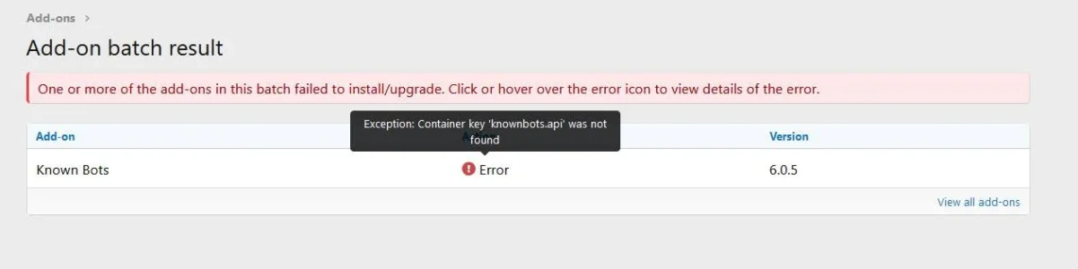

I got some server errors related to this add on, then completely de-installed it, downloaded the new version and when trying to install got this:
this is the server error log
Server error log
  • InvalidArgumentException: Batch install error: Container key 'knownbots.api' was not found
  • src/XF/Container.php:48
  • Generated by: sam2019
  • Jul 21, 2024 at 3:39 AM
Stack trace​
#0 src/XF/App.php(2814): XF\Container->offsetGet('knownbots.api')

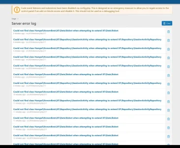

your add-on seems to have developed into a veritable land mine, disabling my forum entirely
I have now completely de installed it but still get this error:
Exception: Could not find class Hampel\KnownBots\XF\Repository\SessionActivity when attempting to extend XF\Repository\SessionActivityRepository in src/XF/Extension.php at line 217
XF\Extension->extendClass() in src/XF/Mvc/Entity/Manager.php at line 295
XF\Mvc\Entity\Manager->getRepository() in src/XF/Mvc/Controller.php at line 1051
XF\Mvc\Controller->repository() in src/XF/Admin/Controller/IndexController.php at line 43
XF\Admin\Controller\IndexController->actionIndex() in src/XF/Mvc/Dispatcher.php at line 362
XF\Mvc\Dispatcher->dispatchClass() in src/XF/Mvc/Dispatcher.php at line 264
XF\Mvc\Dispatcher->dispatchFromMatch() in src/XF/Mvc/Dispatcher.php at line 121
XF\Mvc\Dispatcher->dispatchLoop() in src/XF/Mvc/Dispatcher.php at line 63
XF\Mvc\Dispatcher->run() in src/XF/App.php at line 2777
XF\App->run() in src/XF.php at line 798
XF::runApp() in admin.php at line 15
After I re-installed a freshly downloaded version it seems to work but I would have a look at the de-install routine. it seems to not work as it should.
I just tried to install the addon on a brand new XF2.3 installation and it succeeded with no errors.
I suspect something went wrong with your XF 2.3 upgrade?
Were there any errors logged in relation to uninstalling the addon?
Server error log
Stack trace​
#1 src/addons/Hampel/KnownBots/Setup.php(188): XF\App->offsetGet('knownbots.api')
#2 src/addons/Hampel/KnownBots/Setup.php(110): Hampel\KnownBots\Setup->getApi()
#3 src/addons/Hampel/KnownBots/Setup.php(34): Hampel\KnownBots\Setup->loadBots()
#4 src/XF/AddOn/AddOn.php(575): Hampel\KnownBots\Setup->postInstall(Array)
#5 src/XF/Job/AddOnInstallBatch.php(389): XF\AddOn\AddOn->postInstall(Array)
#6 src/XF/Job/AddOnInstallBatch.php(103): XF\Job\AddOnInstallBatch->stepFinalize(Object(XF\Timer))
#7 src/XF/Job/Manager.php(275): XF\Job\AddOnInstallBatch->run(8)
#8 src/XF/Job/Manager.php(205): XF\Job\Manager->runJobInternal(Array, 8)
#9 src/XF/Job/Manager.php(121): XF\Job\Manager->runJobEntry(Array, 8)
#10 src/XF/Admin/Controller/ToolsController.php(146): XF\Job\Manager->runByIds(Array, 8)
#11 src/XF/Mvc/Dispatcher.php(362): XF\Admin\Controller\ToolsController->actionRunJob(Object(XF\Mvc\ParameterBag))
#12 src/XF/Mvc/Dispatcher.php(264): XF\Mvc\Dispatcher->dispatchClass('XF:Tools', 'RunJob', Object(XF\Mvc\RouteMatch), Object(XF\Admin\Controller\ToolsController), NULL)
#13 src/XF/Mvc/Dispatcher.php(121): XF\Mvc\Dispatcher->dispatchFromMatch(Object(XF\Mvc\RouteMatch), Object(XF\Admin\Controller\ToolsController), NULL)
#14 src/XF/Mvc/Dispatcher.php(63): XF\Mvc\Dispatcher->dispatchLoop(Object(XF\Mvc\RouteMatch))
#15 src/XF/App.php(2777): XF\Mvc\Dispatcher->run()
#16 src/XF.php(798): XF\App->run()
#17 admin.php(15): XF::runApp('XF\\Admin\\App')
#18 {main}
Request state​
array(4) {
["url"] => string(24) "/admin.php?tools/run-job"
["referrer"] => string(57) "https://forum.himalayan-tools.com/admin.php?tools/run-job"
["_GET"] => array(1) {
["tools/run-job"] => string(0) ""
["_POST"] => array(3) {
["_xfRedirect"] => string(92) "https://forum.himalayan-tools.com/admin.php?add-ons/install-from-archive-complete&batch_id=4"
["only_ids"] => string(4) "6045"
Attempting to install the addon with listeners disabled via $config['enableListeners'] = false; will cause the error you found.
Enable listeners first and then re-install the addon.
not true, I re-installed it FIRST, then checked for errors, got none, THEN enabled listeners again, and it still worked.
I would not risk to be kicked out of the forum (which had happened before when I had listeners enabled)
also: before the robots would always count zero - but now they count the actual robots again, so something changed :cool:
The installation routine actually relies on listeners being enabled - it won't work without them enabled. I have tested this and received exactly the same error you first reported.
If you didn't receive the error, then either listeners weren't disabled, or what you did wasn't actually running the "install" routine - for example, re-installing over the top of the existing installed addon without performing a fresh install or an upgrade, won't trigger the error.
I suspect you have some kind of caching going on where you aren't necessarily getting the config settings you think you are.
that is possible. I am on shared environment so limited control over caches and such.
