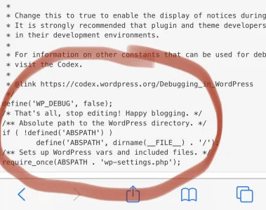

It’s a little above my Pay grade but always willing to go a step above and learn. Do I add it here? wp-config.php- File Under debug line Etc. ($config['development']['enabled'] = true;)
Then go to link and see any errors triggered

However, that doesn't seem overly likely (though plausible). Note that it's the src/config.php file within the directory you where installed XenForo (community/), not the WordPress file you showed above.

It would be your XenForo config (the one in the screenshot is WordPress), which is in the folder where XF is, src/config.php. Though it might be best to just ask your host or server manager if you're not sure.
