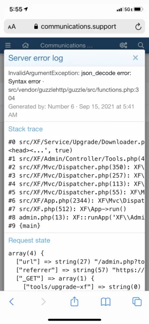

Did you really try to upgrade from you mobile phone? That's brave :eek:
I would never do that. It is better to sit behind a console, take your time, make a backup (or use a test install) and then upgrade.
In case something weird happens, you can revert to the backup.
The screenshot is also very hard to read, it does not show the full error.

Here’s the full error log. Any ideas would be appreciated.
  • InvalidArgumentException: json_decode error: Syntax error
  • src/vendor/guzzlehttp/guzzle/src/functions.php:304
  • Generated by: Number 6
  • Sep 15, 2021 at 5:41 AM
Stack trace​
#0 src/XF/Service/Upgrade/Downloader.php(60): GuzzleHttp\json_decode('<html>
<head><...', true)
#1 src/XF/Admin/Controller/Tools.php(492): XF\Service\Upgrade\Downloader->download(2020770, 1631615533, NULL)
#2 src/XF/Mvc/Dispatcher.php(350): XF\Admin\Controller\Tools->actionUpgradeXf(Object(XF\Mvc\ParameterBag))
#3 src/XF/Mvc/Dispatcher.php(257): XF\Mvc\Dispatcher->dispatchClass('XF:Tools', 'UpgradeXf', Object(XF\Mvc\RouteMatch), Object(XF\Admin\Controller\Tools), NULL)
#4 src/XF/Mvc/Dispatcher.php(113): XF\Mvc\Dispatcher->dispatchFromMatch(Object(XF\Mvc\RouteMatch), Object(XF\Admin\Controller\Tools), NULL)
#5 src/XF/Mvc/Dispatcher.php(55): XF\Mvc\Dispatcher->dispatchLoop(Object(XF\Mvc\RouteMatch))
#6 src/XF/App.php(2344): XF\Mvc\Dispatcher->run()
#7 src/XF.php(512): XF\App->run()
#8 admin.php(13): XF::runApp('XF\\Admin\\App')
#9 {main}
Request state​
array(4) {
["url"] => string(27) "/admin.php?tools/upgrade-xf"
["referrer"] => string(57) "https://communications.support/admin.php?tools/upgrade-xf"
["_GET"] => array(1) {
["tools/upgrade-xf"] => string(0) ""
["_POST"] => array(2) {
["confirm_version_id"] => string(7) "2020770"
