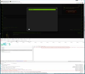

However, when I load it as a xenForm, I get this:
My JS files are sent in opposite order of input.

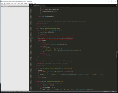

I took a look in the source code and found this:
And did not find any place where it gets reversed back.

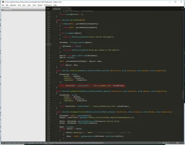

This is the way I render the page:
Please advice.

I have to admit I'm not sure I understand the need for that array reverse, but even removed, array_unique sorts. Essentially, the order of the JS files is generally considered to be non-deterministic. This is very significant in your example as when the JS files are dynamically loaded, they're loaded and executed simultaneously (as they come in). As such, your code needs to handle a situation where its initial execution is triggered before other JS files are loaded; the best method here is to attach your actual activation code into the XF JS framework system which will only be triggered when everything is loaded.
As this line actually predates the 1.0 beta release and changing it wouldn't end up fixing this issue, I'm not going to change it at this time.
