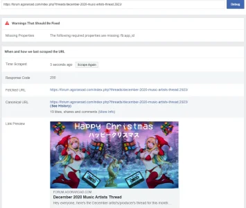

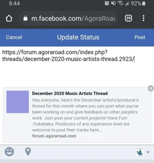

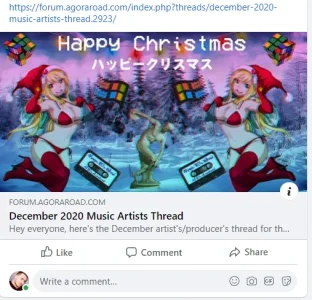

Would there be any reason its not working on this page? Its not getting the Christmas image
JoyFreak
It is working. You can see it in the unfurl link. Where are you trying to share it?
JoyFreak
I meant on Facebook sorry
The debugger shows the image is working and I even shared it on my personal FB and it seems to work just fine. Could just be a cache issue, it seems like you are viewing it on mobile. Sometimes it takes a while for it load, so come off the app and on and it should work.
