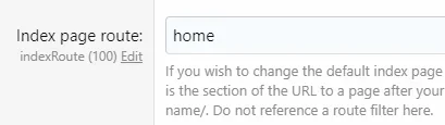

In that case XF needs to be installed in the domain root if you want the add-on to be the root URL - site.com.
With the Index page route in the options being set to the recommended value for the add-on.
XF will then automatically use /forums for the forums route.

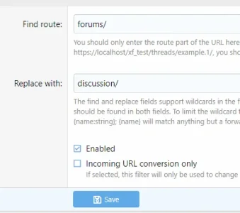

When I've added the route filter for
forums/
discussion/
When going to /discussion, it seems to just re-direct to the root/home page. Not quite sure why. I was wondering if it's because of the rewrite file.

So I've re-enabled the forum / discussion route filter and added home to the index page route.
I'm still getting the same issue. When clicking on the discussion tab from the site route, the page just refreshes and doesn't actually go to the forums.
