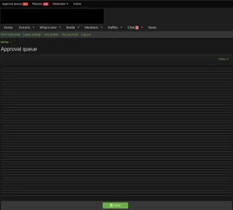

  2. The approval queue shows how many approvals are outstanding, but when selected, the html structure loads, but nothing is populated. The xf_approval_queue table shows the correct amount of rows (as shown on the user interface) and has three columns: content_type, content_id, and content_date. Are these correct? Is there any other reason why this data wouldn't show?

Both issues were fixed by correctly updating the xf_ip table user_id_log_date index to include keys for uiser_id, content_id, ip, and log_date.
