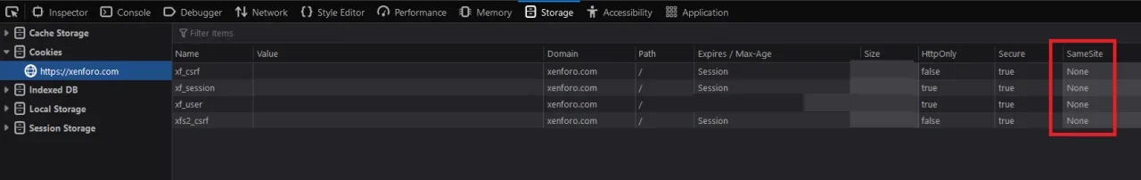

They are also set to SameSite None on xenforo.com
The pertinent change there was that XF stopped setting any explicit policy and allowed browsers to enforce their default policy. The default policy varies by browser. Prior to that change XF had set Lax explicitly, overriding the browser's default policy, which causes issues due to bugs in some browsers which have not yet switched their default policy.
If your cookies were explicitly set to None then it was either because that was configured in XF, or your web server, browser, or other intermediate service sets a policy for cookies without one.

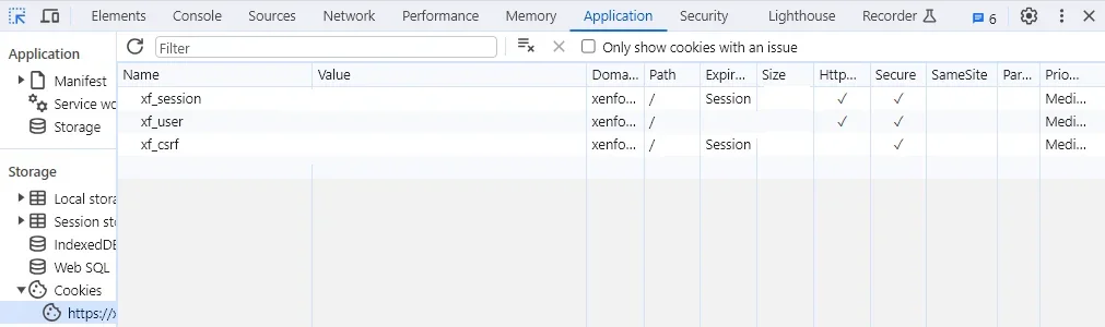

This may be due to a browser extension then as that is not actually the case for XF.com:
Okay I tested in chromium and Strict breaks staying logged in from another website. Strange that it works on firefox, something funky must be happening.

If your cookies were explicitly set to None then it was either because that was configured explicitly in XF or your web server (or other intermediate service) set an explicit policy for cookies without one.

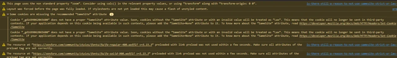

It's strange because Firefox isn't complaining about XenForo's cookies lacking SameSite. It only complains about the _gd cookie that Froala sets.
So it would seem None is being explicitly set.
... And very interesting, In chromium the SameSite is just missing.
Interesting indeed. Maybe Im missing the firefox warning because the cookie gets set when I'm not looking at web developer tools.
That means that Firefox has not yet begun setting SameSite Lax into all cookies then. And I'm using up to date firefox. (119.0)

Ah, I was mistaken. Firefox and Safari have not yet changed their default policy. I've edited my posts to prevent confusion for future readers. Firefox also displays the default policy value in the inspector whereas Chrome just leaves it blank. I'm a bit surprised as Chrome changed the default policy years ago, but it appears to be because they deploy exceptions as mitigations for common breakages that others have yet to implement.
