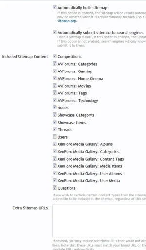

Mike XenForo developer Staff member Jan 29, 2015 #2 The last ones don't appear to have finished. Have you installed any add-ons that might change the sitemap? Upvote 0 Downvote

Stuart Wright Well-known member Jan 29, 2015 #4 Mike said: The last ones don't appear to have finished. Have you installed any add-ons that might change the sitemap? Click to expand... Yes If I run the cron job manually, it completes immediately and the log is not updated. Is there a way to tell what's happening? Upvote 0 Downvote

Mike XenForo developer Staff member Jan 29, 2015 #5 Don't run the cron job. That just kicks off the process. Run the option under rebuild caches. That should give some hints at least. Upvote 0 Downvote

Stuart Wright Well-known member Jan 29, 2015 #6 Thank you. I think it's the competitions addon because the rebuild process doesn't seem to get past that. Disabling it takes the rebuild forward through the other content. Have alerted Chris D. Thank you. Upvote 0 Downvote

Stuart Wright Well-known member Jan 29, 2015 #7 Confirmed - it's rebuilt correctly after disabling the competitions sitemap. Many thanks, all. Upvote 0 Downvote
