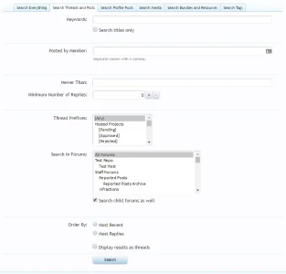

I just purchased the ES addon. I am excited to use it. I am taking things slowly, so I installed this addon, and had a look at my search dialog before enabling ES. I found that the default order was not set, most likely because the ES addon sets the default order to "relevance", even if it is not enabled yet.
I made the following change:

Which makes it refrain from changing the default unless the ES addon is enabled.
Before:
After:
I hope you will accept this patch.
