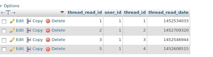

Quick migration question. I had my fresh install but then I made a few test threads to test out the addons I am using. Then I deleted the threads. However, I read this in the import instructions:
"After selecting the system to import from, you have the option of retaining the existing IDs for imported users, forums, threads, etc. This is only possible when importing into a new installation with no existing data."
So that got me thinking those tests threads I made but deleted might be an issue when I do the migration. Will they be? I poked around in the database and noticed this:
Those aren't records from the thread table; that's a table that isn't imported. So based on what you showed, it won't interfere. However, we don't recommend generating any content if you want to import while retaining IDs. If you don't want to retain IDs, it's not really an issue.

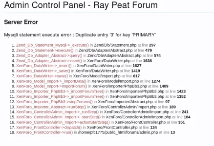

I'd recommend making a backup at this point and if you're sure you've (hard) deleted any content you created, you can try the import while maintaining IDs.
These are the exact sort of errors that happen from content being created. A forum/node in this case. This is an example of what you need to be sure didn't happen if you are trying to maintain IDs. At this point, ideally, go to a pre-import backup, remove more content you created (threads, forums, users, attachments, etc) and start the import again.
Everything was hard deleted, no forums were made, all attachments/avatars were deleted, no users were made.
