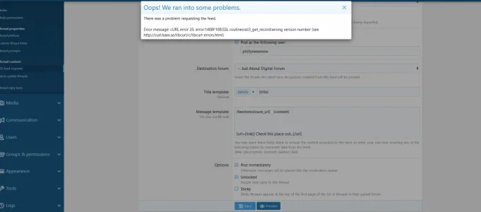

Imported RSS Feed Curl Error
This looks to be a server configuration issue so not something we can provide support with directly.
But I came across this issue https://github.com/curl/curl/issues/2324 which implies that it could be related to a misconfigured http_proxy or https_proxy value in /etc/environment.
Your host would be the first port of call in this instance.
That was just one possible solution. Either way, the issue is happening because curl is failing the SSL handshake to the remote server. The handling is entirely out of our hands at that point so troubleshooting your cURL and server configuration is what is required.

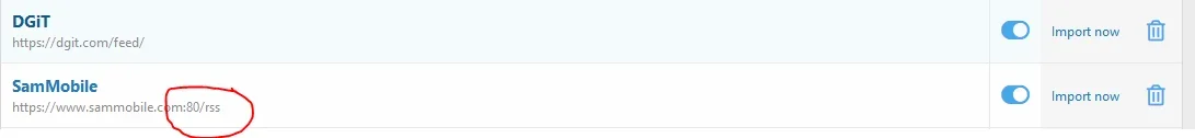

it was pointed out that during the import using the "xenforo importer" it imported the url but added the ":80" after the domain url, see image after adjusting the url it went through without issue. so server configration was never the issue but an importer issue.
There is nothing in our code or the importer code that would append :80 to the feed URLs so this may have existed in the original database.
