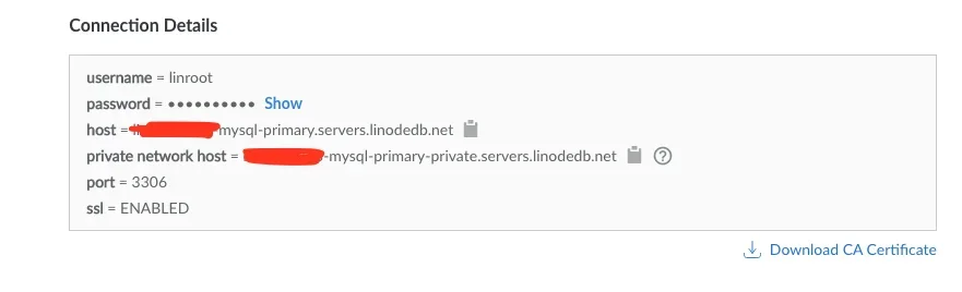

We just configured Linode's DBaaS tonight and heres what our config looks like:
PHP:
$config['db']['host'] = '<Linode Private DB URL>';
$config['db']['port'] = '3306';
$config['db']['username'] = '<db_user>';
$config['db']['password'] = '<db_password>';
$config['db']['dbname'] = '<dbname>';
$config['db']['ssl']['enabled'] = true;
$config['db']['ssl']['ca'] = 'src/db_ca.pem';
We are running php-fpm8.1; We placed the downloadable certificate in the /src folder named db_ca.pem.
In our case it is a symlink to our certificates folder.

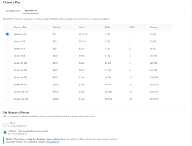

Hmm .. quite a pricing premium over running it yourself on a node
True, but you are paying for them managing everything. You click a button to deploy a HA cluster with everything already set up. That’s the point in it being “managed”, you pay for the managed part.

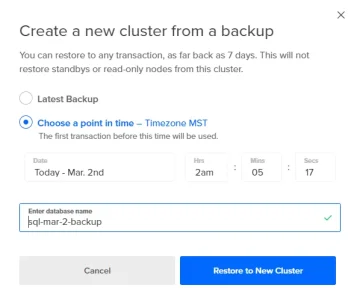

We used to be on DigitalOcean's offering and we switched to Linode because of the Cloudflare Bandwidth Alliance. In comparison for the same Master-Slave-Slave failover, you'd pay 70$ for the basic offering w/ DO.
Feature wise, DO Beats Linode (for now) in terms of statistics, query/log viewing, and backup offerings.
With DO, you get to the second restore points, where Linode is done daily (at this time); however I can understand if they keep it to daily backups considering the price difference (35 vs 70)
However with Stats and Query/Log viewing, you will have to utilize third party tools to query your endpoint and see whats poppin' as Linode currently does not offer a comparable service.
At this time Linode does not charge for their service while it is in Beta.
