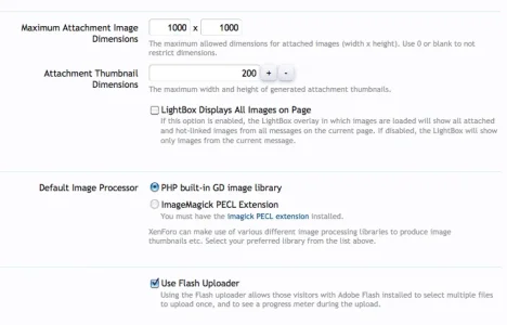

Can anyone advise if I have missed a setting somewhere? All I can see in attachments that relates is:
Max attachment size is set to a huge 100MB (100024KB).
Alternatively is this indeed coded into the forum and if so, where can I change it please.

The only other thing I can think of is it's running out of memory, though this is set quite high for a shared host? There's nothing in the Xenforo server error logs either.
Bingo, thanks Brogan:
Note that with XenForo 1.1 and above, images of 16 megapixels and over will not be resized; this is to prevent fatal errors due to running out of memory. If the Maximum Attachment Image Dimensions combined total (width x height) is set lower than this limit, images greater than 16 megapixels, or with a dimension larger than that permitted, will be rejected with an error stating The uploaded image is too big. If the Maximum Attachment Image Dimensions combined total (width x height) is set to 0 or greater than 16 megapixels, the image will appear as an attachment without a thumbnail.
